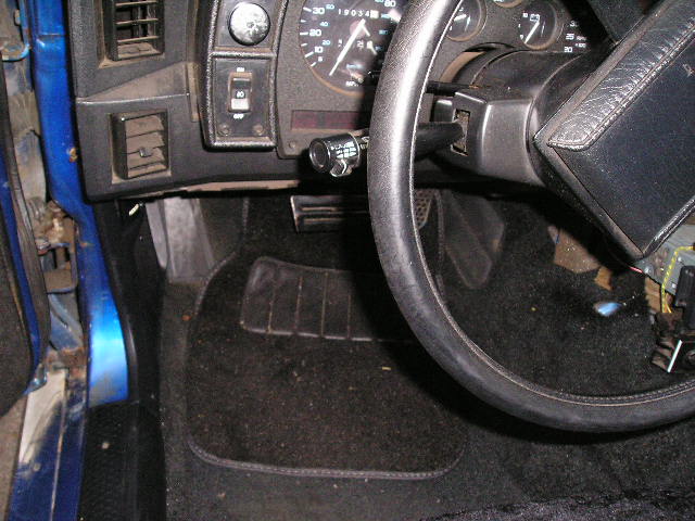

only thing to mess with (other then removing EFI wires) is there is a starter enable relay inside the drivers side kick panel(inside car, to left of drivers feet), it is behind some black gooey s***, you will need to jump/bypass it to work the starter

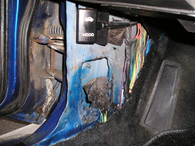

ok, the panel is the one to the left

here is the panel off
Attached Thumbnails Vats Problems When Switching To Carb From TBI-p7090002.jpg
Old Jul 9, 2003 | 04:18 PM
Dave Y's Avatar
Joined: Aug 2002
Posts: 676
From: Detroit, Michigan
Car: 04 Xtreme Blazer
Engine: 4.3L V6
here is the relay
Attached Thumbnails Vats Problems When Switching To Carb From TBI-p7090003.jpg
Old Jul 9, 2003 | 04:21 PM
Dave Y's Avatar
Joined: Aug 2002
Posts: 676
Engine: 4.3L V6
you need to cross the yellow wires with the green one

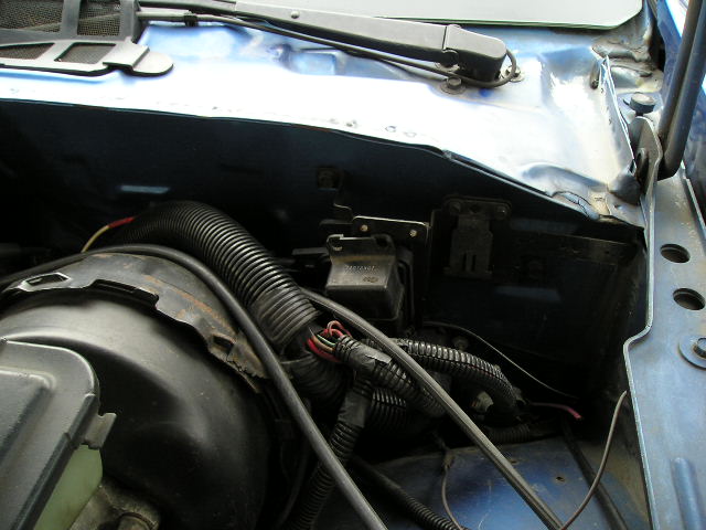

here is the fuel pump relay, it is the square one
Attached Thumbnails Vats Problems When Switching To Carb From TBI-p7090008.jpg
Old Jul 9, 2003 | 04:24 PM
Dave Y's Avatar
Joined: Aug 2002
Posts: 676
Engine: 4.3L V6
on the fuel pump relay, you need to cut the dark green w/white stripe and the black w/white stripe, then, run the black/white wire to ground and the green/white one you need to hook to a 12v source that is hot when the key is on ONLY!, leave the relay in place and your pump will energize when the key is on
