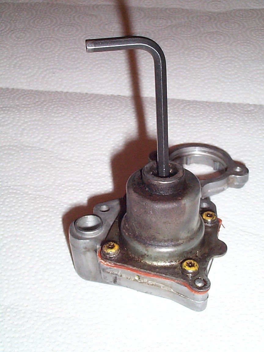

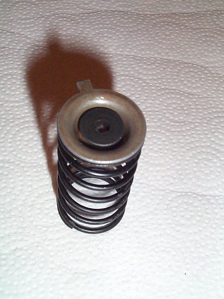

Agreed that the fuel pressure is a bit lower than a comfort-level measurement. I fought a couple of TBIs with pressure on the low end and they were temperamental, fussy, and quirky in some of the operating modes. One was a Fiero manual, and when I modded the TBI pod to regulate pressure up nearer the 13 PSI end, several troublesome issues improved.

It may not need a fuel pump. The FPR in the "rebuilt" TBI unit may or may not be set where you need it. The replaced spring may also not be sufficient.
If you restrict the return line and test the dead-head pressure of the pump, you can find out. It will require a few adapters and fittings, but is all top-side work and probably easier than dropping the fuel tank.

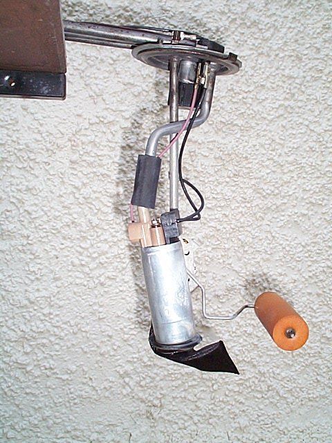

The prior assumption could very well be correct, but an extra bit of time checking it out from the top could save a lot of frustration if changing the pump does nothing for improving pressure.
Yes, a pump without a return line could hit 20 PSI, but don't run it that way for more than a few seconds. I don't believe the later years had the pulsation damper in the tank like the '84-ish models had, so there should be no risk of bursting that.
Also, I've had a couple surprises "fixing" fuel pumps that wouldn't consistently make pressure. The one in the photo came out of the tank exactly as you see it, and sometimes would make the correct pressure. The car had been in an accident and I think the kinetics of the impact did the "inertial disconnection" shown.
