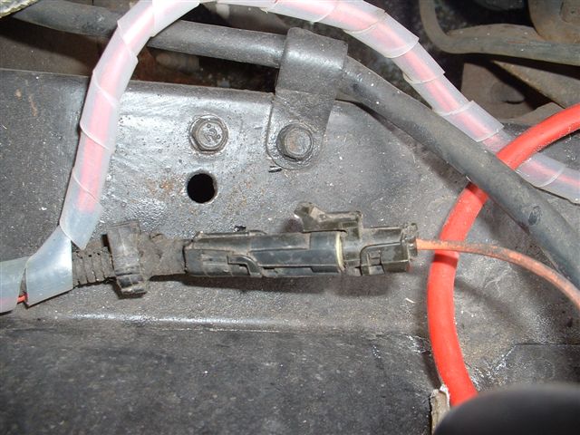

Hello,
I need to identify this item in my engine bay. It is located on a wire near my battery. When I open it, it has a thin metal spike in it. I have never seen this in any car! My car is a non starter with the fuel pump not priming and my local garages get scared when you tell them it is an American car.
There is no fuse that I can see for the fuel pump in the fuse block either?
Many thanks in advance.
Steve

the connector in the pic looks like the power feed to the computer, at least it looks exactly like the one in my car.

I think that is the power wire to the ecm. Check to see if you can turn your fuel pump on with the aldl port, i believe you apply 12 volts to terminal G but you should double check with a search on the board. Also check to see if your getting an injector pulse. If not check to see that the computer is gettin 12volts. If it's not look for a fuse in a capsule and check that.

Matrixra- That looks like a fuse holder. You say there was a metal spike in it? Not a fuse w/ glass and metal on the ends? Could it be possible that the fuse blew and some one put a piece of metal to jumper it? If so, there is a short somewhere that would make the fuse blow.
The white smoke by the distrubutor- what does it smell like? Burning oil- gas? or acrid electrical smell? If its the latter smell, I would guess the solid fuse (if thats what is in your fuse holder) is letting enough amperage thru to fry the guts of the distributor.
Get a new fuse. If it blows right away there is a short somewhere. If it is the power feed to the ECM, post a message about it on the ECM board. They might have some more info. Hope to have been of help!

Hey Man that is your power wire to your ecm

smoke coming from behind the engine sounds like it maybe the fusable links. id check thoes. they come off the starter. their such a bitch to get at.
