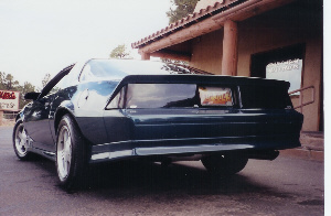

Hey buddy...First off, I wanna warn you about something. I posted a topic awhile back about the "euro style" altezza tail lights for third gens. I got SO MUCH CRAP about it, it isn't even funny. I simply asked if anyone made them and everyone posted replies about how I shouldn't own a Camaro and I should go out and buy a *****. You should really watch what you say cuz there are some people in here who are pretty damn brutal. But while we're on the topic of clear tail lights, I've done many searches and I couldn't find any company that makes 'em. The only modification I know of are the GTS blackouts. Anything else, you'll have to do on your own whether it be painting the plastic lenses or modding them some other way. Good luck in whatever you decide to do man. Later.
