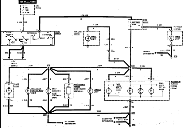

alldatadiy.com has detailed diagrams. He'res an example. I found the site very helpful.
