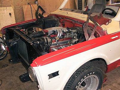

Here's a diagram of the switch wiring.. http://www.deadbird.org/imagesold/tpi3.gif
This is my bud's '72 350 Chevy truck. I put an 88 GTA TPI on it, there is no oil pressures switch because I cut it off (no provision on a '72 block for it)... runs just fine..

Hey deadbird, Thanks for posting that schematic. The TPI looks sweet mounted inside that P/U. Nice of you to help out your buddy with the swap.
I was wondering if:
1. Did you use the stock GTA wiring harness or aftermarket?
2. Was the ECM PROM stock GTA programming or aftermarket?
This info might help us understand jimmysauter problem. I don’t have a Fuel Injected car so I can’t try to duplicate this problem.

Well, I realize everyone has their own interpretation of how it works and alot of other are just plain confused due to bad information. This ramble is just mine from a little research and having completely rewired my 'bird and the '72.
The TPI in the truck is a MAF setup running the stock PROM and stock harness. The ECM did work but, not correctly. It would not go into diagnostic mode and it stopped controlling the IAC. It was replaced with one from AZone and now works fine.
The ECM harness also came with the TPI. I simply modified the harness to hide wiring and eleminate the oil press switch since it isn't needed for operation. The interior harness is from 3 different v6 camaro's spliced together to make a complete harness.
What's actually in the engine ? not a clue but, it seems to not irritate the stock programming (because of it being MAF TPI and probably not to wild of a motor). It did run like crap (rough.. as if it had a fairly large cam) initially but, after some general tuning and paying attention to hand turning the motor, it was found there was a good amount of slack in the timing chain causing enough retard to the cam to make it run rough (the chain had enough slack to touch the block). After a double roller chain swap, it runs very smoothe.
I have also modified the stock tank to accept a OEM type in tank pump.
