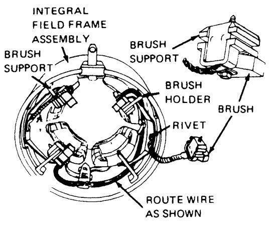

I may have mis-worded my post. On the starter solenoid, You have the two small posts marked "R" & "S". You have the big stud and below it is a post with a threaded hole in it. The battery cable and the wires with the fusible links go on the big stud. There is a brass or copper stand-off post (either a short or long one) that goes between that post with the threaded hole and the strap on the starter. A bolt goes through the strap & stand-off post connecting them to the starter solenoid. This strap I'm talking about is actually two straps on some starters and are called the series and shunt coil connectors that connect to the brushes around the armature inside the starter.
Attached Thumbnails ignition/starter problem?-cva.jpg
