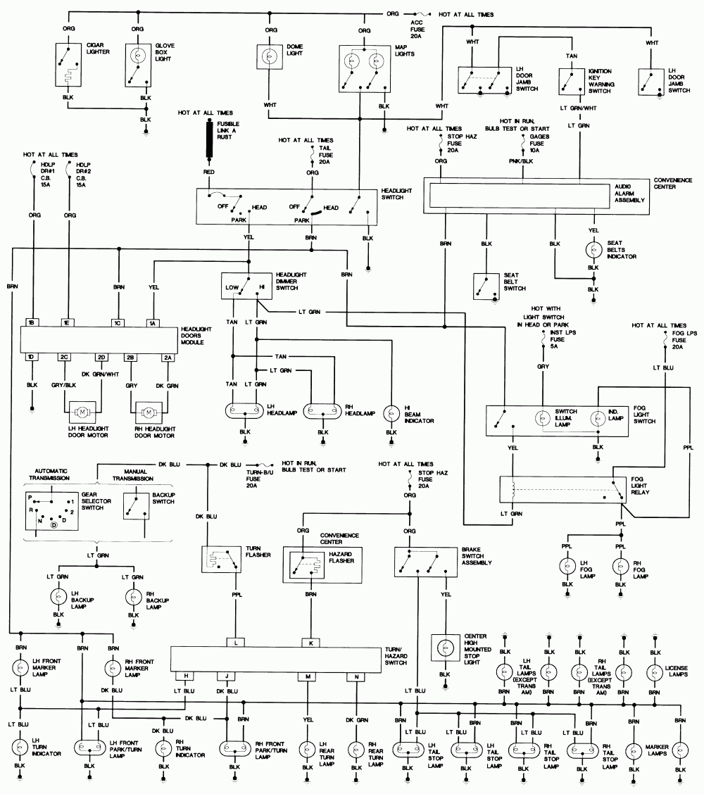

The stop/hazard fuse supplies constant power to the buzzer at all times. You may have missed something when you were working on the dimmer switch. Check this schematic out.

Lol... figured it out. =P
I didn't have the gauges hooked up yet. After plugging the gauges in for a quick check, the buzzer works fine.
