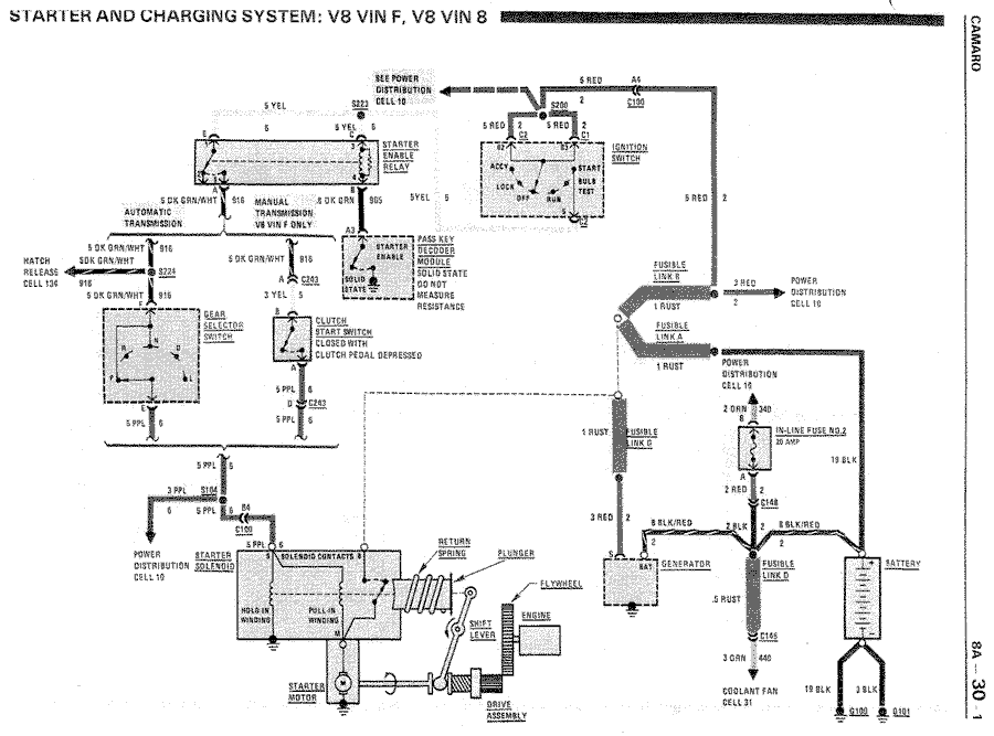

Would anyone know what to check or what wire it is to have your accessories on when you turn the keys to you. I would like to listen to my radio and be able to open and close the windows on accessorie instead of leaving it on ignition.

Do you think this will help. BTW, the ignition switch shown in this schematic is the one located on the steering column under the dash.

Thanks, you led me to the right direction.
