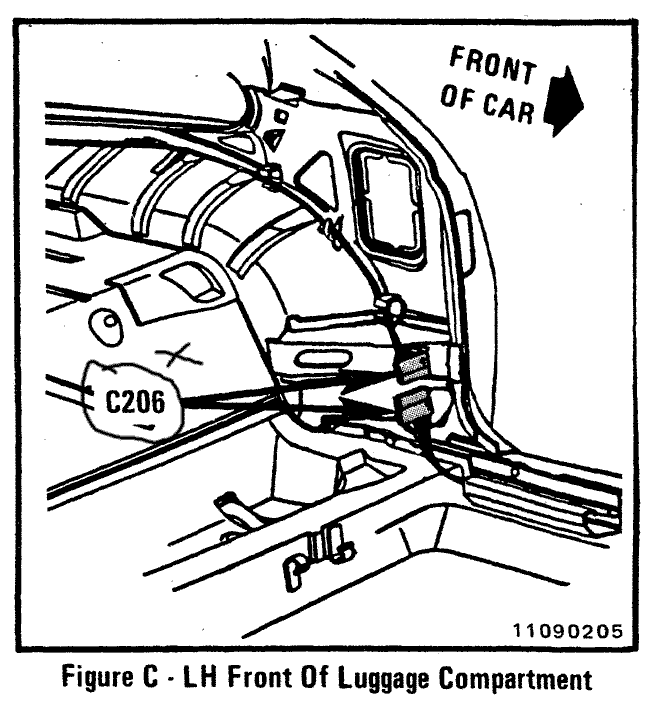

Check out this schematic, you will notice a connector marked C206 that I have put an "X" by in the first picture. It is located under the left rear speaker behind the trim panel. The wire harness for the rear lights go through it. The second picture shows it.

i diidnt know about that connection.....i checked the one in the drivers side cubby hole in the rear hatch area behind that little storage compartment...were the rear lights harness attaches and it didnt have any power other then the HOT...i hit the brake pedal while the motor was running and nothing was at the female end of it..(the side closet to the front of the car) i turned on the turn signal and nothing either....so thats when i started farting around on the column and under the dash...today when i get off work ill go to my dads and hook the battery up and all the ECM stuff so i have some power and will check that connection.....by the looks of it its right under the drivers back seat...

That be where it's at, just back of the door near the left speaker. That is also where the wires for the hatch release & pull down assembly join together.
