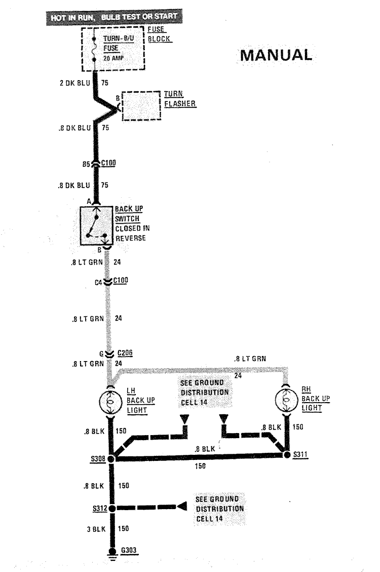

Does anyone know what the orange and black/white wires on the shifter are for? and are the blue and green wires for the reverse lights? If so, can I hook them straight up to the pig tail that goes to the t-5?

Orange/black wire goes to ECM, black/white wire is ECM ground, the green wire goes to your backup lights and the blue wire goes to the turn flasher and turn/backup fuse. Blue wire and green wire would go to the backup switch for a manual. Not sure about the other two wires.
