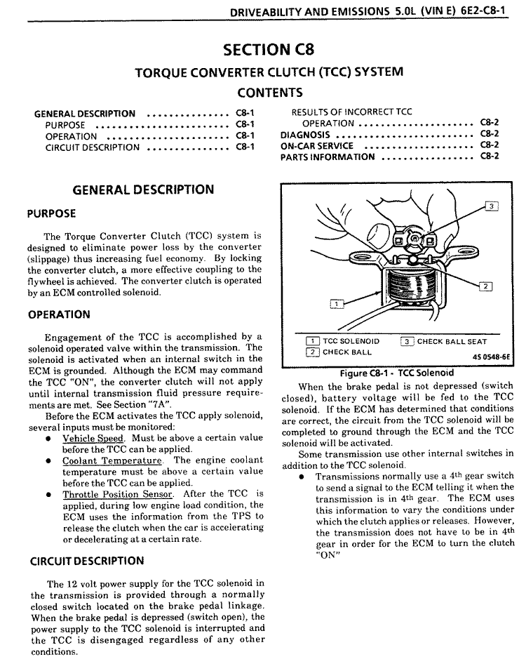

Hello FruityOne,
How are you doing today, glad you liked those schematics I sent you. If you will look at the schematic labeled "Engine Data Sensors and Transmission Converter Clutch". You will notice that the "Gage" fuse connects to pin "B" of the Brake switch with a pink/black wire. A purple wire goes from pin "A" of the Brake switch to pin "A" of the Torque Converter solenoid (four pin connector on driver side of transmission case). Is it possible that you may have messed up the wires for the Torque Converter Clutch solenoid inside the transmission case when you were doing that shift kit modification.

Hello FruityOne,
Here are a couple more pages that I don't think I sent you yesterday.
Attached Thumbnails Gauge fuse blows every time the ignition is set to "on"-1ac.gif

page 2
Attached Thumbnails Gauge fuse blows every time the ignition is set to "on"-1ad.gif

Its possible something could have gotten into the connecter during install. Something that my interrupt the TCC signals.
The transmission case was painted, I wonder if something could have gotten into the connector and interfered with the TCC.
I'll have to do something about that. Maybe replace the switch itself?

My assumptions were correct. There is something in that plastic connector that is interfering with the circuit. I popped the harness side of the connector off the transmission and I no longer blow fuses.
