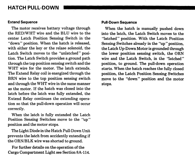

Actually it does Morley. I mention the hatch release inside the car as his other means of opening the hatch. If that also doesn't work, he needs to look at the fuses and go from there.

When I bought my 91 formula the entire hatch release and motor drive were inop BUT the key would still release the hatch, the key has absolutly nothing to do with any of the electrical parts of the hatch release.
