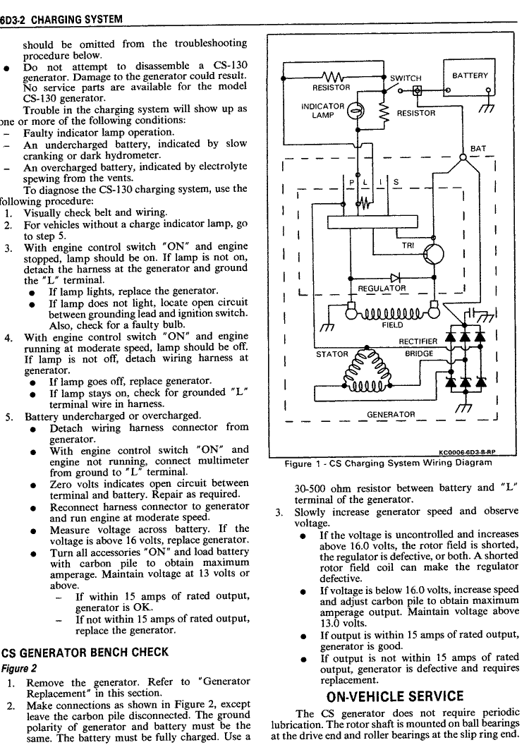

Here is a diagnosis procedure for checking out a no charge problem that you can look at. Have you tried checking the alternator voltage with the engine running by putting a volt meter on the battery and checking voltage. It should read about 14.5 volts if the aternator and wiring is working properly. voltage will increase as rpm's go up. If you drained that new battery by trying to crank it, try putting a good charge on it with a battery charger and see if it holds a charge. I had an alternator go out on me one time and it spiked the battery and had it reading 19 volts and almost zero amps.

page 2
