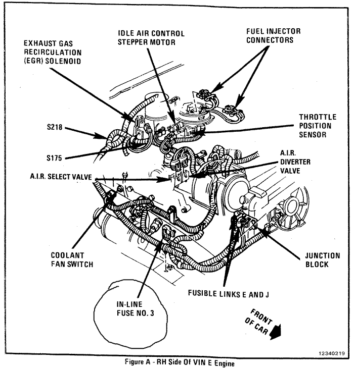

No, I mean a 20 AMP in-line fuse. See attached picture.

thats awsome thanks alot

Be careful when you unplug it to check the fuse, that connector is probably brittle. Mine broke when I looked at it funny...
