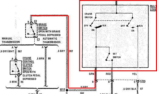

I have looked EVERYWHERE, i cannot find the in car connector he is holding in the pic https://www.thirdgen.org/newdesign/t...cruisefix2.jpg , i have cruise, but i had to cut the wire off of the turn signal arm because it was cut anyways, well i wanna do the cruise control to buttons in ashtray mod, but I cant find that thing... any suggestions?
Can I find the wires that it needs to be tapped somewhere under the hood? just gettin real mad, cause I have totally redone my steering like 2 times, so I know under my dash pretty well

I had to go back and look at that picture again when it dawned on me you said the connector that he is holding. I hate to tell you but that is the piece you cut off. The connector that it goes into has four wires to it, they are pink/black, gray, blue, and gray/black

Okay, that one has probably been tucked up with another wire harness. It comes down from the dash to the left of the steering column near the fuse panel. Do you need a schematic for it?

sure that diagram would be cool :hail:

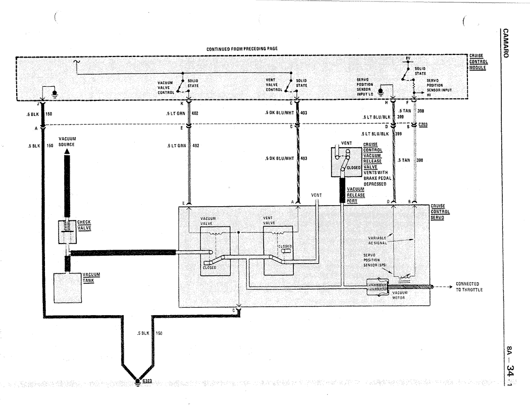

page 2

where in the diagram do I gota deal with?

I drew on that, maybe it will aid me in makin sense
Can I follow the wire off brake pedal red to the plug?

Look for the connector marked C235 in the first picture and go from there. That is the connector that you are trying to find under the dash.

I see C235 in 2 places and how do I find something that will lead me to that under the dash?
where it says C235 C D B, is the brake switch wire on B?

I FOUND IT!! hehe thx for all your help
:hail:
One end was commin outta where you said, but it was hard to see cause the former owner or somethin covered the 4 wires with electrical tape, i found a small section they missed n recognizezd the colors
