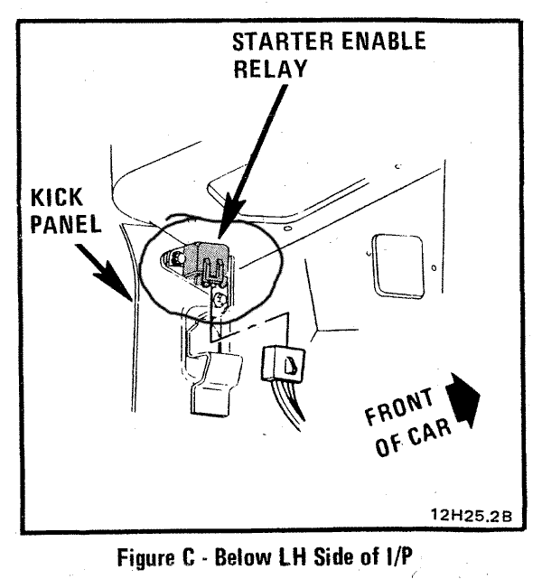

i checked all connections last night. big yellow wire is hooked, the green, the pink, and no power to the purple wire going to the starter. neutral safety switch is good, too. where is the vats starter enable relay and what does it look like? i'm pretty sure thats what went south...thanks, Patrick

It is located behind the left kick panel and has four wires going to it. They will be a yellow wire and a pink wire coming from the ignition switch. A dark green wire going to the park/neutral switch and a black/yellow wire going to the VATS control module. Here is a picture of the starter enable relay and its general loaction, this varies in different models as to the precise placing of it. Just look for the wires mentioned above if you don't see it.
