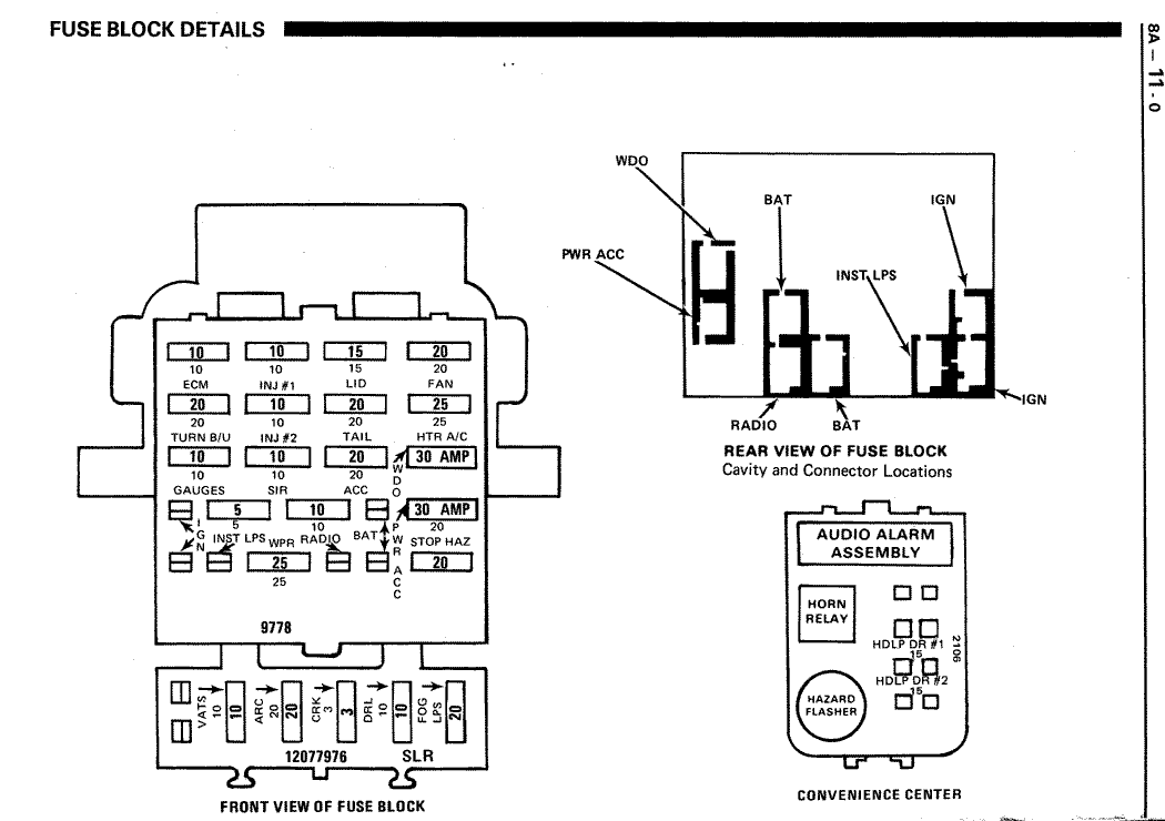

gauge lights and driving light fuse keeps poping randomly... any one know the name of the fuse i cant undersand the letters on my fuse box they are worn off ... but does anyone know what can cause this? it popped while driving then i replaced it and it popped and then again... its weird because it works for a little then pops... wtf? please help i have no interior lights except the dome light and i cant see at night... thanx bro's

Will this help? It is the fuse panel out of a 92 camaro and should be the same as a 91. The fuse is the "TAIL" fuse and sends power to the light switch. You might have a bare wire in the circuit grounding out somewhere.
