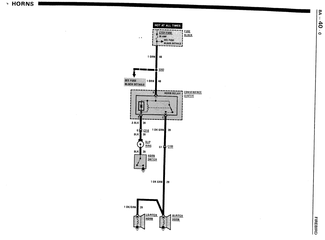

can someone show me the whole wiring set up from the horn to the actual button in the steering wheel, i can't get mine to work, and i have no idea where to trace the wires from... any help?

Yes, here is a schematic of the horn system for your car. You will notice a little circular item in the schematic labeled "slip ring. This a circular piece of plastic with a metal ring on the backside of it and fits on the steering wheel hub and makes contact with the turn signal cam follower. It has a little tower on it that the wire from the horn button fits in. Have you checked the horn relay in the convenience center to see if it is good?
