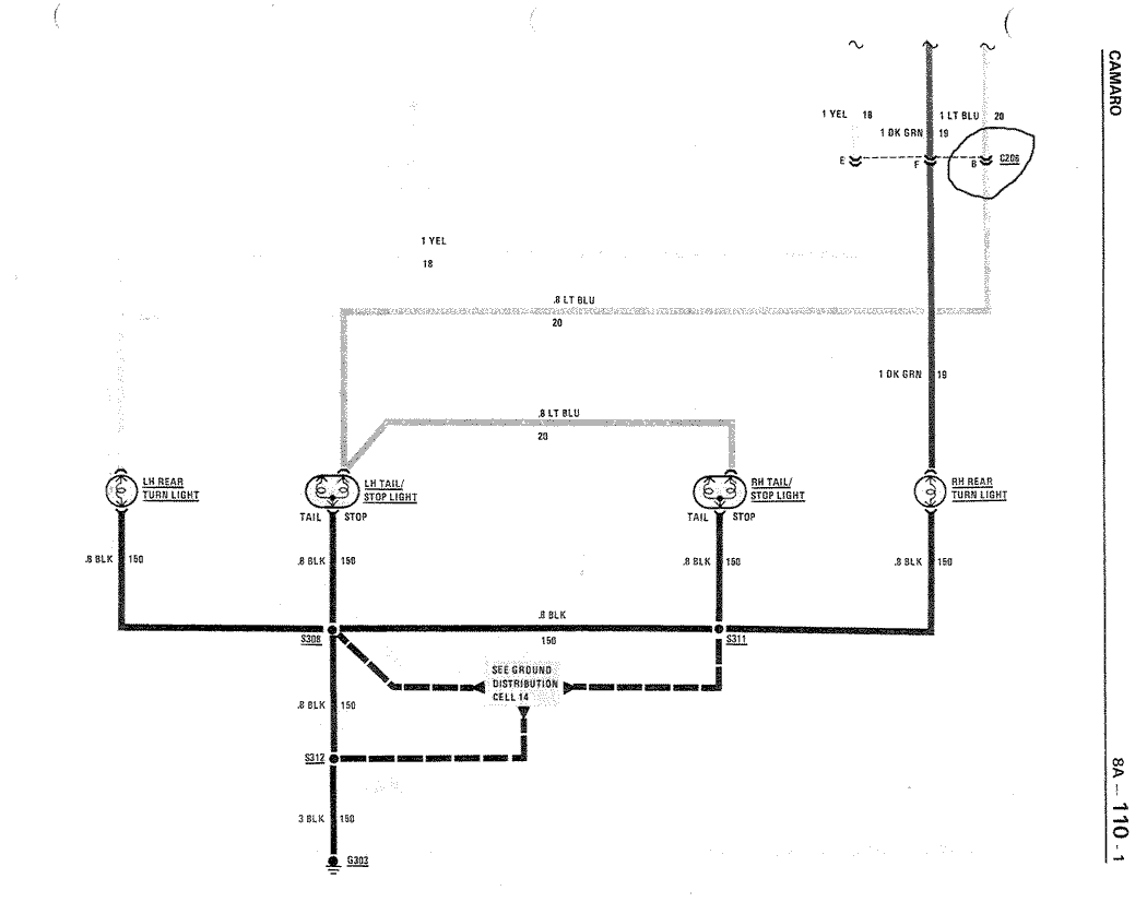

having an electrical problem here. on a 90 RS, the center brake light works, but the two tailight brake lights won't light up. I have replaced both bulbs so they're both good. The bulbs will light up with the headlights on for tailights at night, but won't function as brakelights in either setting. The center brake light works in both cases, which removed the thought of the brake light switch going bad. What else could cause running lights, but no stoplights out of the same bulbs since power is obviously going to them ?

Doesn't matter if the high brakelight works, the brakelight switch is still bad.
The switch has 2 sets of contacts....one for the regular brakelights and a seperate one for the high brakelight. Your problem is most likely corroded contacts in the switch, but wiring between the switch and the back of the car is also a possibility. If it comes down to wiring, I'm sure Trickster will stick a diagram up here for you.
Bad or weak ground is pretty much eliminated, since the brake, tail, turn, and backup lights all use the same ground.
Bad or weak ground is pretty much eliminated, since the brake, tail, turn, and backup lights all use the same ground. Thread Starter

As TheGreatJ has mentioned, there are two circuits in the brake switch. One for the regular brake lights and one for the center brake lights. If you need it I can put the schematic up for you. BTW, those are dual element bulbs that should be in there

just checked out the brake light switch and there was no loose connectors. Still no brake lights besides the center brake light. I looked at my service manual and saw that one connector is for the cruise control to shut off in the event of braking. The other connector goes to the brakes. Obviously there must be a loose wire somewhere, although it's strange that the running lights work since the same grouping of wires are basically going that way. Any schematics or other ideas on what i should be looking for ?

There are two wires going to the main brake lights. One is a light blue one from the brake switch that goes through pin "B" of connector C206 located below the left rear speaker. The second wire is a brown one that goes from pin "E" of the light switch though pin "D" of connector C206 to the main brake lights. Your problem is undoubtably somewhere in that light blue wire. Just a thought. Here is a picture of the light blue wire going to the brake light.
