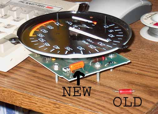

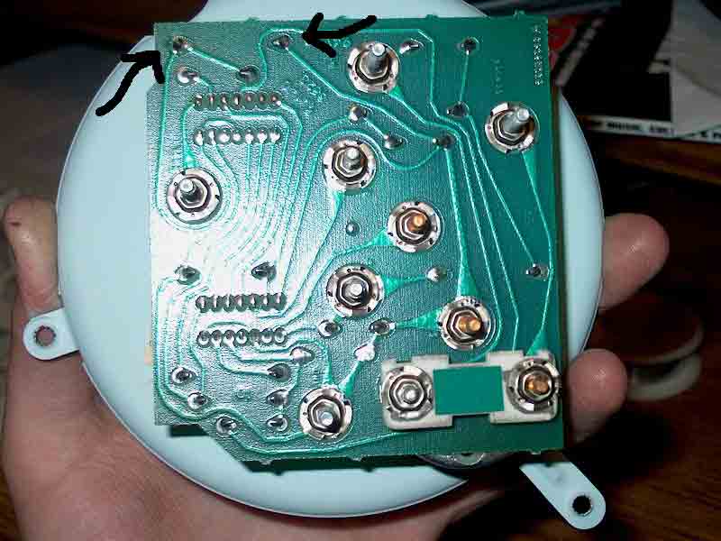

I did a ton of research some months ago on this board and alot of people said that the problem was a capacitor on the back of the tach (I think this is what Berlinetta was trying to think of). The solution to the problem is just taking the old capacitor off and soldering a new one on. The only problem is that no one seems to know what rating the capacitor should be. Some say it should be the stock rating and some say it should be a different rating. I may sometime soon try this (with a capacitor at the stock rating), just to see what happens. I have an Autometer tach installed so that way I can check to see if the stock tach is right or not. We'll see how it goes.

I had the same problem with mine, bought anohter tach in the scrapyard, still had the problem, bought a V6 tach and changed the capacitor as discussed in another thread, same problem! My car's tach filter has to be bad but I cannot locate it (should be inline with the white lead coming from the coil). If I knew what the rating was for this piece, and where it was, I could replace it. Any ideas??

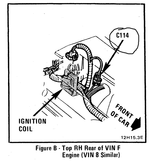

That is because there isn't a tach filter on your car MurcoRS. There is only the diagnostic connector in that circuit. The tach filter that you are thinking about was used on the earlier distributors with the internal coil. I posted that schematic and filter location on this thread.
https://www.thirdgen.org/techbb2/sho...hreadid=231471
Now in this first picture you will notice that I have circled the tach diagnostic connector, it is labeled "C114". The second picture here shows the location of that connector in the engine compartment. Now as an added bonus I am including at no extra charge, shipping and handling is extra though. A picture suitable for framing, of the capacitors located on the tachometer circuit board that has been mentioned earlier. Enjoy!!!!!!!!!! :lala:

Well, now I am bummed... I've done that modification already with the new capacitor and I still have the needle pegging! Well, now I have an excuse to get an AutoMeter gauge set...
