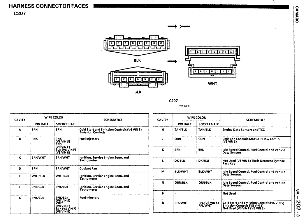

P.S. what would be really cool... if you could tell me some time what each one of the wires in the little connector by the ECM are, the one that connects all the inner car stuff to the ECM and the outer car harness(well not the wires on the drivers side), mine is white maybe 16 pin or so. I need to know what they are on the 89 2.8 and the TBI cars (not sure of the year I got the harness out of) I know there are tons of wires in there that are different, not sure the books go by connectors tho.

Here is a picture of the connector C207 that you are referring to. The wires are the same for all the 89 models. Back to the problem with your starting, disconnect the two wire connector for the lock cylinder under the dash. Take one of your keys and attach two wires to the contacts on it and put the other end in the connector going to the module. Now use the other key to try and start the car, if it starts replace the lock cylinder.

wow that was fast... that is half the problem, now i just need the ECM side. How do i determine what year the harness in my car now is? or maybe you can look through them and post a few different years if they are different? Known factors... car was manual, ECM is 8746 which is a reman so I cant look for any dates in there... pretty much leaves late 80's early 90's

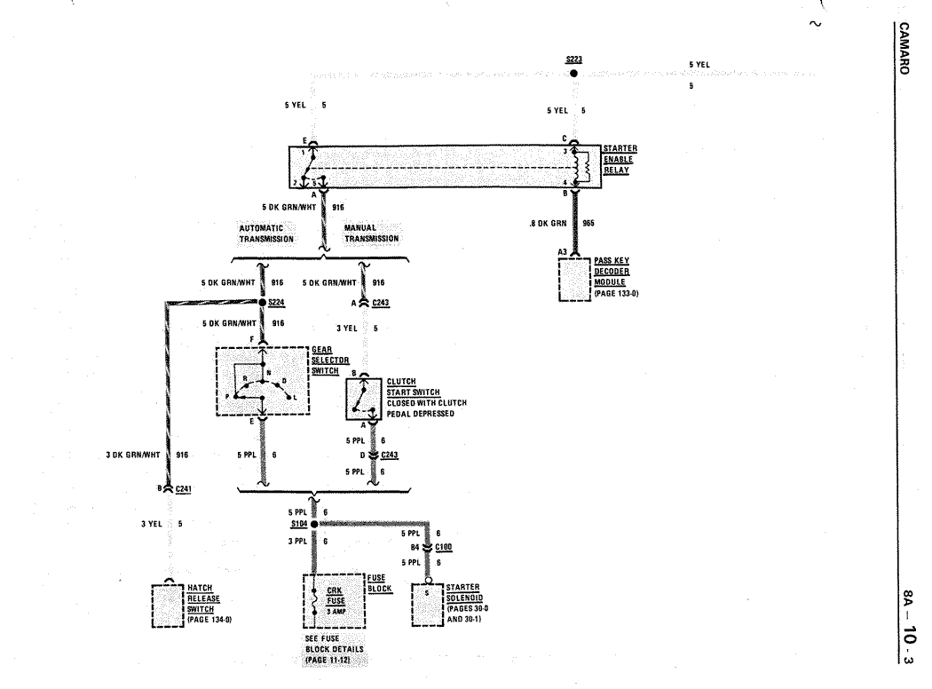

I tried it... nothing, not even a little bit. Would you happen to have a schematic or the wires for the starter switch itself, on top of the steering column? I think I wanna check and make sure the wire that supplies the power is supplying... other than that I guess if that is ok the only other thing is the VATS box itself? I am getting sick of starting my car with a screw driver!

You looking for something like this?

Aparantly my VATS has previously been disabled... I know this how?... cause my car likes to start (YES, with the key) with and without the VATS resistor wire hooked up ... thats right, it likes to START... so aparantly the stupid rod that pulls the switch straightned itself out... i even tore the switch off the collumn and it did not move, was still at max adjustment even... HOW DOES A METAL ROD STRAIGHTEN ITS SELF OUT!!!! oh well at least it starts now... at least I got some good info out of the C207 connector... BY THE WAY, ever look and see if you can find another one of those that is different?
