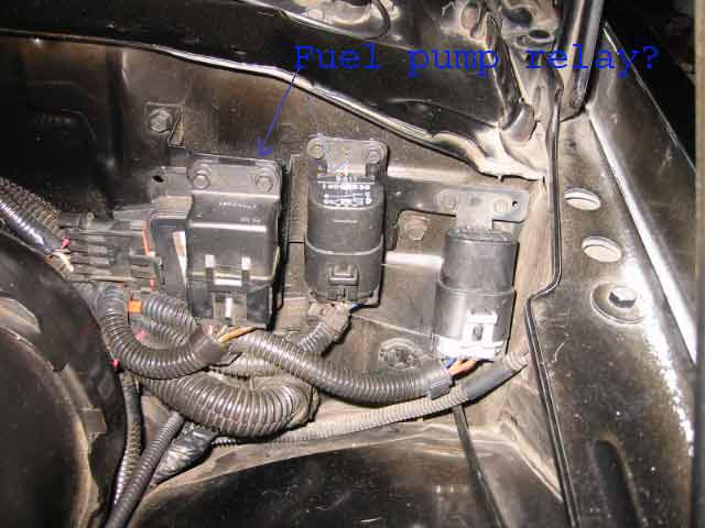

This is pretty much the area im lost at, the Haynes manual sucks as far as telling/showing me where the relays are, or what I should be looking for as far as possible problems. The plug itself looks fine, ill recheck the sensor also. Thanks Trickster.
Old Sep 1, 2004 | 08:34 PM
Trickster's Avatar
Posts: 6,127
Likes: 12
From: conway, s.c.
Car: 1989 Iroc-Z
Engine: 5.7L TPI
Here is a picture of the relays, the MAF relays are the ones to the right of the fuel pump relay on the driver side firewall.

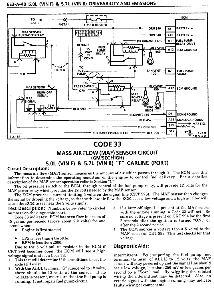

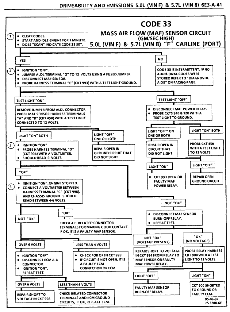

very nice Trickster thanks!! I did check the middle one, the plug itself looked fine, should I unbolt them from the wall and check them? Also, is there any way you could tell me what readings I could take at the plug going into the sensor itself?
Old Sep 1, 2004 | 08:50 PM
Trickster's Avatar
Posts: 6,127
Likes: 12
From: conway, s.c.
Car: 1989 Iroc-Z
Engine: 5.7L TPI
Sure, here is a chart for the code 33 that should help you.

Old Sep 1, 2004 | 08:51 PM
Trickster's Avatar
Posts: 6,127
Likes: 12
From: conway, s.c.
Car: 1989 Iroc-Z
Engine: 5.7L TPI
part 2
