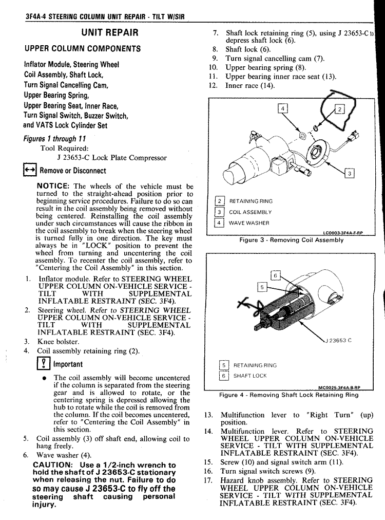

Here, maybe this will help you out. Use a tool like the one in figure #4 and depress the plastic piece so you can remove the retaining ring that holds that plastic piece on the shaft. Once that retaining ring is removed it will come off with no problem. Just don't break the wire harness it is attached too. Also, I hope you disconnected the battery before you started this project. BTW, the retaining ring is item #2 in figure #3

Trickster,
I appreciate this. These are much better instructions than anything I have found. As far as the retaining ring, I already took that snap ring off. You'll notice that the ring is already off in the picture. Maybe I'm just not pulling hard enough on it. I disconnected the battery and the SIR fuse. I followed these instructions.

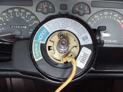

Well, I have to say a big thank you to Trickster. The diagrams convinced me that I just wasn't pry on it hard enough. It was not easy to get the plastic cover out. I just kept wiggling it and pulling until it came out. I did put the key in and hooked up the battery and nothing blew up. Thanks to both of you. Here are some pictures. Maybe this will help someone else doing this.

I replaced the bottom spring.

I took off an airbag, a steering wheel, a plastic cover, a metal cover, used at least half a dozen tools, to replace a little broken spring.
