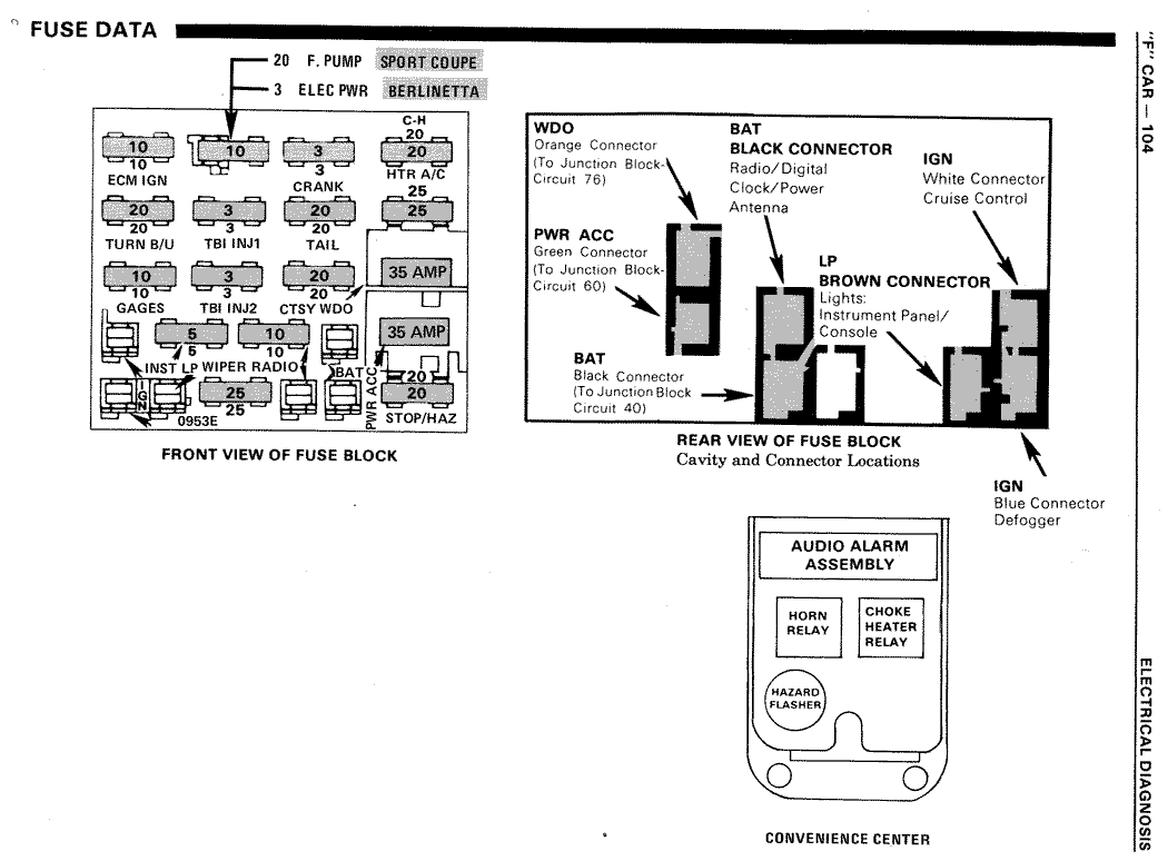

ok i know this is gonna be one of those nub questions. but i keep blowing my gague fuse and another one but i can't read waht it says cause it wore off. thier proabally a short in the line but i can't find it

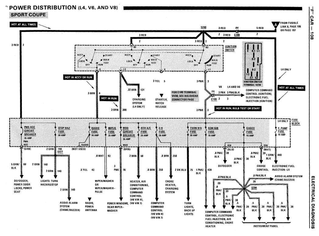

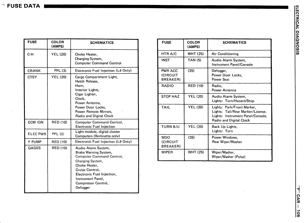

Here is a picture of your fuse block, a list of the components served by each fuse, and a schematic of the gage fuse. Hope this helps.

page 2

page 3

ok i'm blwoing my ecm ign and my gauges. and they both have fuel inection and computer conrtoll comand in common so would it be soem were in between thier
