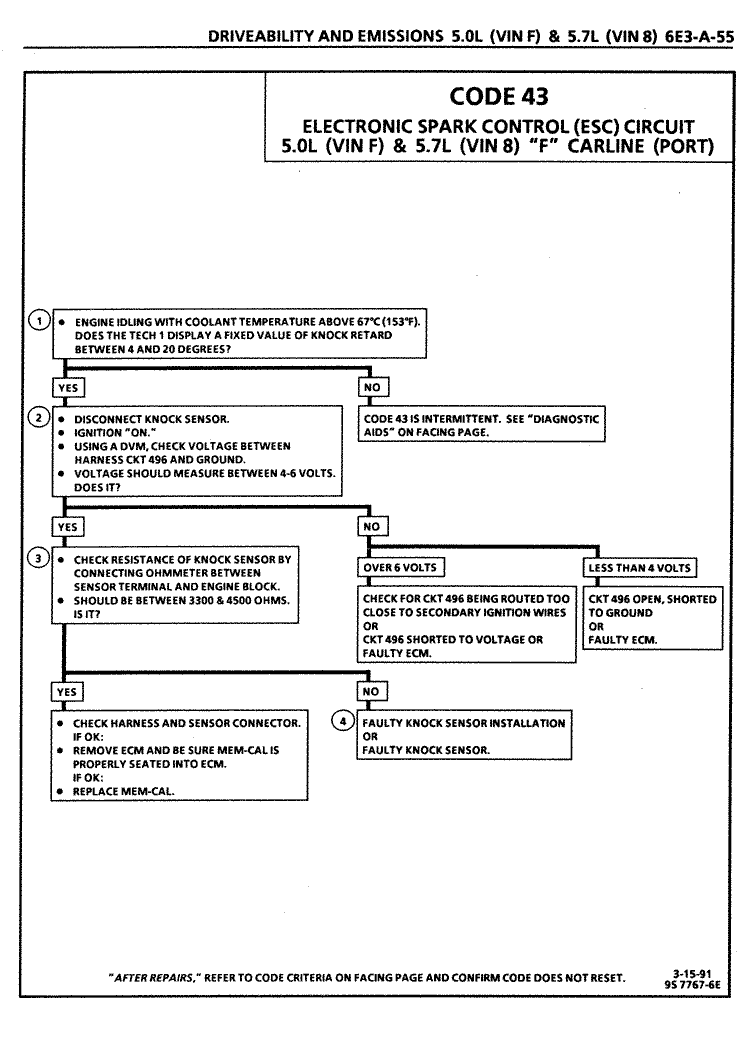

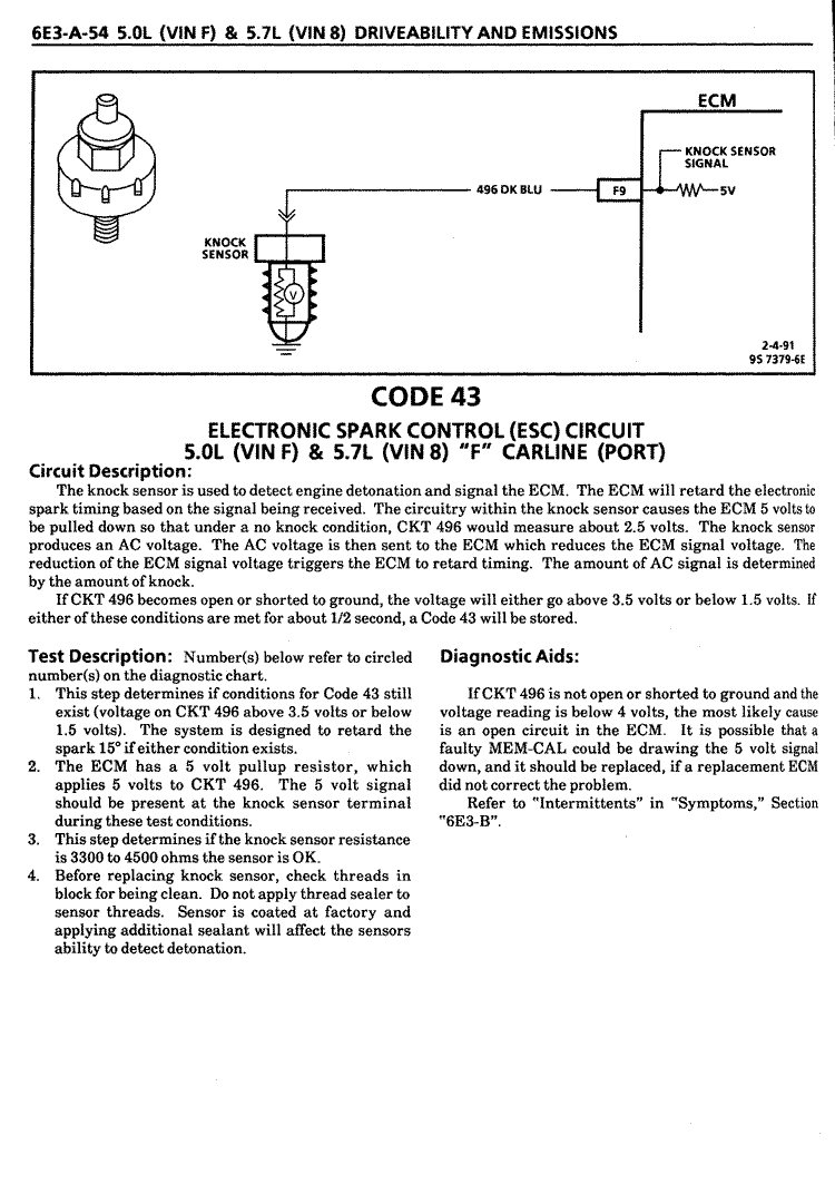

How to test it
I know where it is but my question is how do you test it. My haynes manual says normally it sends 8-10 volts to the ecm and when a knock is detected it shuts off. But then it says the opposite in the testing. If it is good with the key in the on position how much voltage or whatever measurement should it be putting out? Thanks.

Yeah i got that wire but I can't find what voltage is supposed to be there. The haynes says if no knock is detected then 8-10 volts. But that does not seem right. Thanks.

Old Oct 22, 2004 | 01:21 PM
Trickster's Avatar
Posts: 6,127
Likes: 12
From: conway, s.c.
Car: 1989 Iroc-Z
Engine: 5.7L TPI
Hello Pave Tim,
Perhaps this will be of a little more use than your Haynes manual.
Old Oct 22, 2004 | 01:22 PM
Trickster's Avatar
Posts: 6,127
Likes: 12
From: conway, s.c.
Car: 1989 Iroc-Z
Engine: 5.7L TPI
page 2
