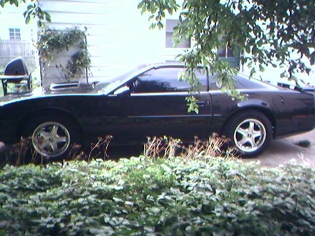

what do you suggest? i want my car to be safe, cause i park it sometimes in bad parts of town.
