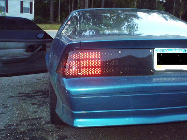

eLED is where I got my parts for these:

I didn't see any of those LEDs on eLED.com but I didn't check too well. Those taillights are very impressive, did you do that whole fabrication yourself?
