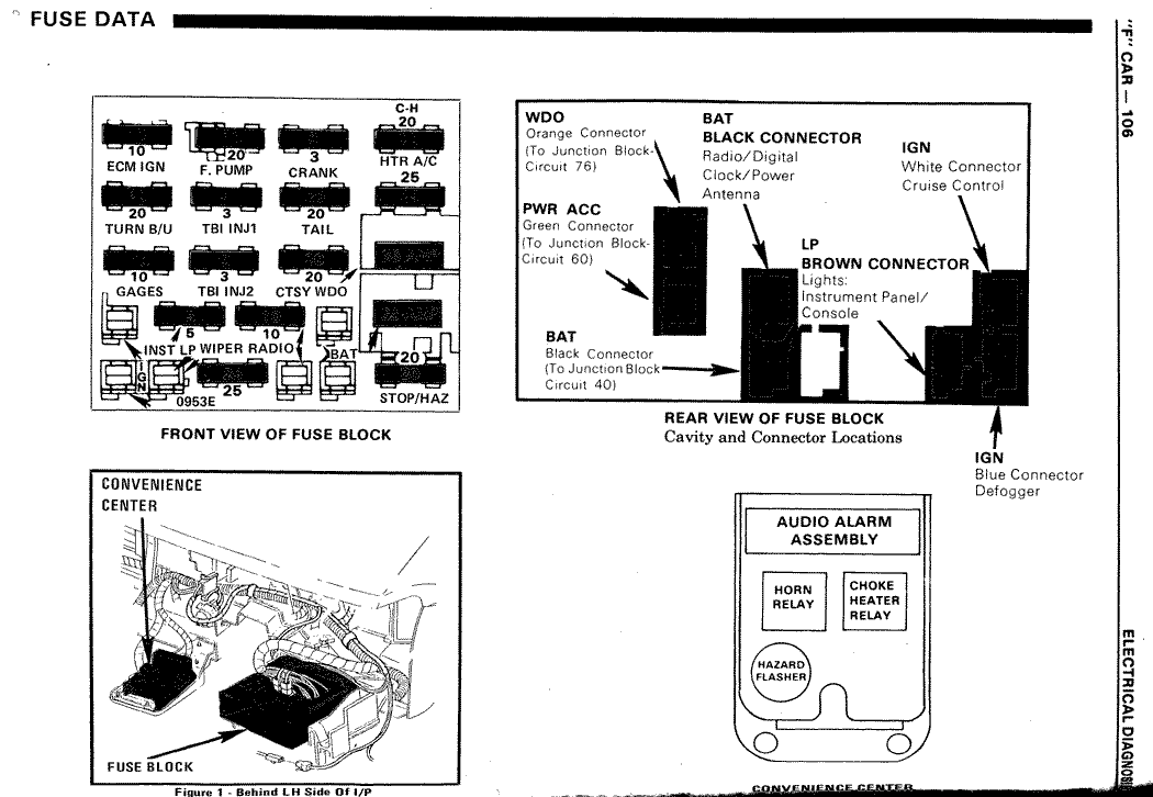

Hey,
I got one prob. The pre-owner ripped out all fuses, 'cause he was searching for an defect.
But he didn't put them back.
So now I need a plan which fuse is located where. You know.
Does anyone got something for me?
Thanks guys,
Hawk

Hello HawkeyeGT,
I have the info you requested and will post it later.

and here it is.
