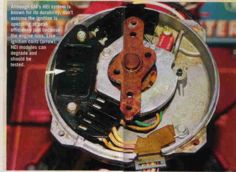

I think most <a style='text-decoration: none; border-bottom: 3px double;' href="http:/www.serverlogic3.com/lm/rtl3.asp?si=24&k=auto%20part%20stores" onmouseover="window.status='auto part stores'; return true;" onmouseout="window.status=''; return true;">auto part stores</a> can check the ignition module for you but you will have to remove it from the distributor.
Jim.
Attached Thumbnails Ignition coil-c-documents-settings-berry
