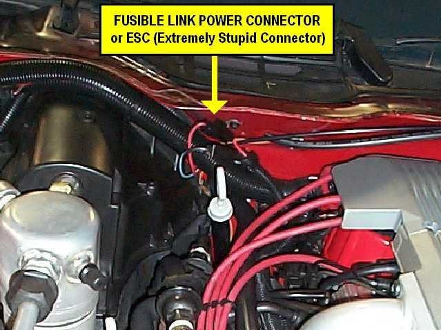

You can test a couple of the starter fuse links at this connector:

thank you Lord Vader , Ill check that out right away.
