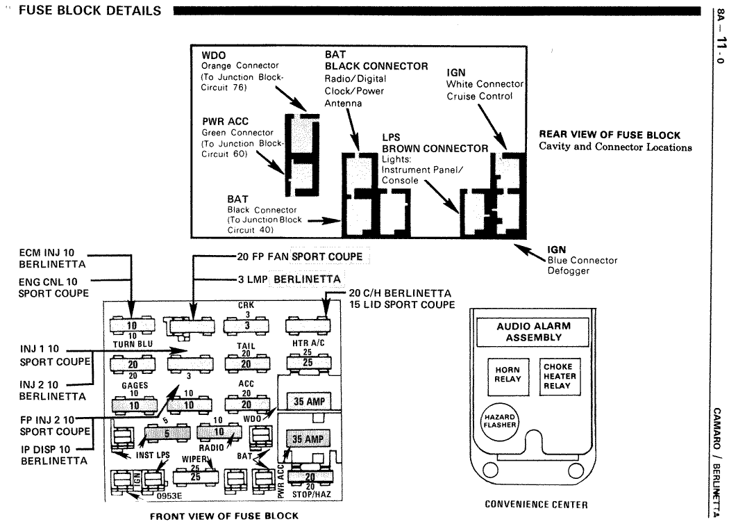

Anybody have a pic of the fuse panel in an 86 that clearly shows which fuse is which?
the markings in my fuse box have worn off over the years and I can't read it anymore.
If you could post it here, or send to me in an Email, that would be cool
Thanks

Perhaps this will help you.

thanks, that helps alot
