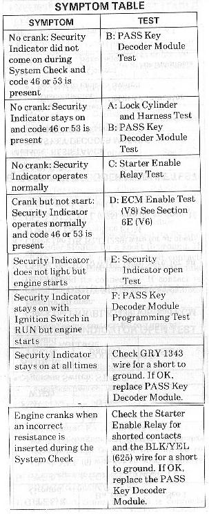

The security light is supposed to come on for a second or two. If it stays on...

if your security light is staying on it is a pas key or vats issue, I would start by looking at the orange wire coming out of the steering column these get cut into for aftermarlet alarms often. Then take a look at the start enable relay, it is located under the drivers side kick panel (right by your left foot when driving) the relay has a plastic cover which is removable. You will be able to see if the pass key module is enabling the starter or not. Worse comes to worse you can measure the resistance in the key and wire a resistor into the wiring that goes to the ignition cylnder.

If the light is not coming on then he has a broken wire in the steering column. If it comes on and stays on there are several things that could cause that.
1. bad module
2. short at gray wire to security light from module.
3. bad contacts in lock cylinder not reading key.
He said that the car would not, does he mean that it wouldn't turn over (crank) or that it just wouldn't fire up? Another thing that would cause it to not start is the park/neutral switch being out of position.
Another thought here is, does he have an after market alarm system in the car.
