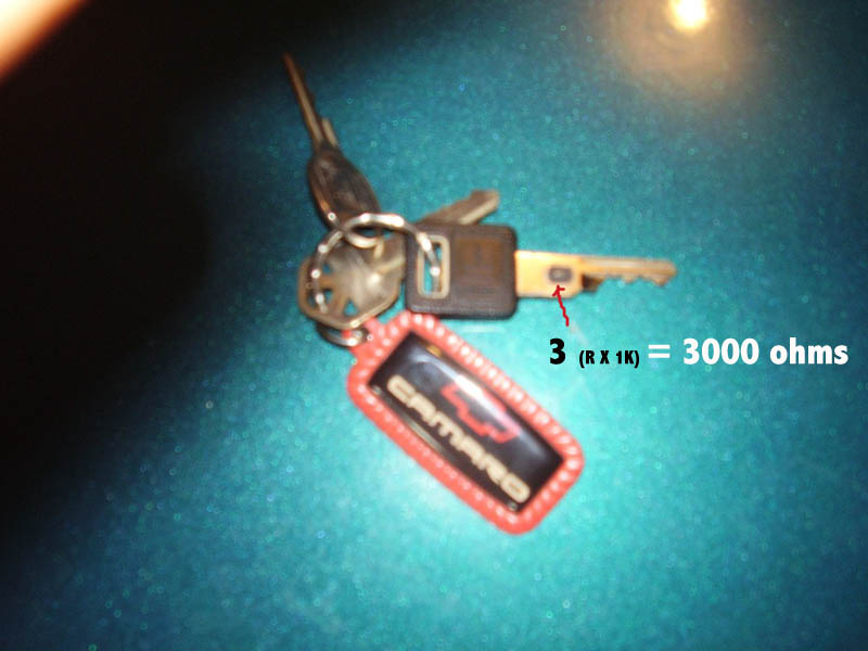

HEre is the key

I was reading the vats manual lo-tec sent me. (very helpful) and it says the exceptable ranges for a (3010 pellet) Which I suppose would be me is (2890 - 3150)
Being that I have a 3300 - does this mean the resistor could be the problem?

I cant find one of these daggon resistors to match my key. I've been using the ohms adjust dial on the tester to get the exact reading so when I went back and re-tested my key. I actually have a 4 ohms key or maybe a 3.9?
Still I cant seem to find a resistor that will comply!
