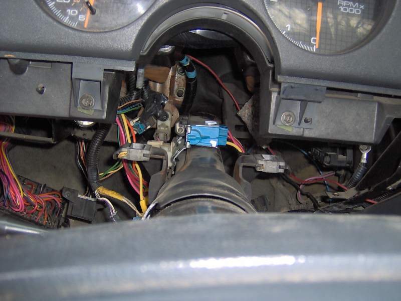

I just droped the steering cloumn and in the process the fuel pump primed and i got power for just one sec. As i was sifting through the wires it came on and off a few more times. I got to the ignition switch but i tried jumping all the wires across the harnesses at the ign. switch but got nothing. Going to take some pics. Trickster? Youve got me back and going several times. If you get me going this time i think that youll have to send me a bill

as it is now
