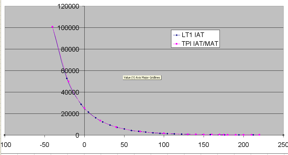

I plotted the Data on a microsoft excel chart. You could probably use the TPI sensor.

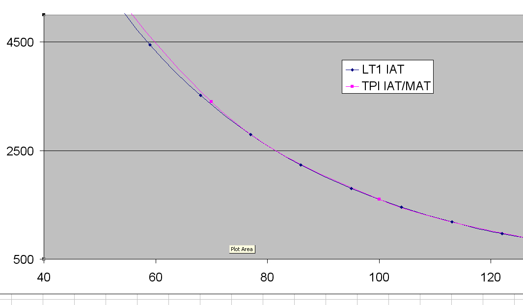

Here it is zoomed in at the temperature ranges from 40-120.
