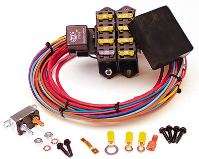

I just seen this in the summit catolog and it looks like something that might work.
Painless Performance Cirkit Boss Auxiliary Fuse Blocks: PRF-70207 - summitracing.com
