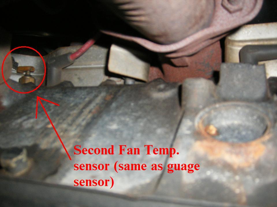

Awesome, I just put those exact same headers in my 87 Trans Am. And yes, I had to replace (actually, replacing since they are still in the garage) the same sensors. I didn't "need" to replace three of those, but I figured I might as well since my car is 20yrs old.
Oxygen senors:
I just went to the autoparts store and got the regular oem replacement. I believe I got a Bosch(sp?) O2 sensor for 82-92 F-bodies. The O2 bung on the driver side header should be same as the oem on the manifold.
Engine Temp Gauge sensor:
This one is between the first two spark plugs on the driver side. This one I didn't have to replace, but I did. Its rather simple. It just a bolt with a nail-like tip you just hook or unhook. Last one you'll need is...
Fan Temp sensor:
This is the exact same sensor on as the engine temp gauge, except that its between the last two spark plugs on the passenger side. I broke this one and had to replace it. This sensor is to activate the second fan when the engine temp reaches 220(I think)...I'll include a pic of this sensor...

The coolant temp sensor should be on your intake manifold. On mine, its under the throttle body...
