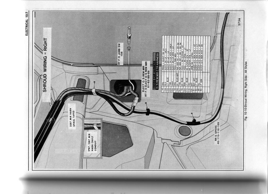

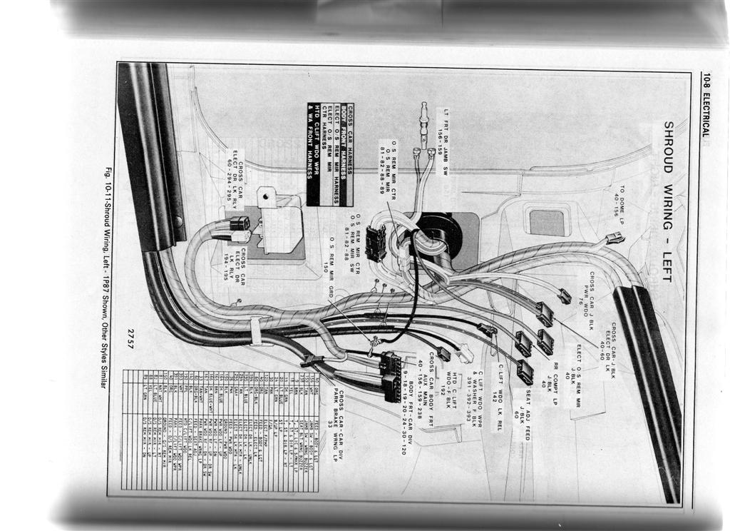

Here are a few diagrams to hepl you troublshoot you door switch porblem. These are from the 82 Camaro Service Manual, but I suspect that the wiring follows the same general routing in you car.
These are body diagrams showing the wiring harness routing. As Lou suggested above, you need to follow the WHITE wires from the switches.
I suggest you right click on the images below and "Save Link As" to your computer. Then open the file in some picture viewer software so you can rotate and zoom in to read or print them.

You can find the harness for the done light on the top center portion of the left shroud page I posted yesterday.
Also, here is the wiring diagram from the 82 Camaro service manual. I expect that your car is wired the same for these lights. Note that if you have courtsey lights in the hush panels under the driver's and passenger's side dashes that the WHITE wire (#156) could be grounded running to them also, or to the light switch in the dash.
