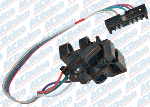

Originally Posted by xgtharo86x
ttt.....is there anyway i can rig up the wires so it just turns on.....what would i have to buy and where can it new?
The attachments below are from the 82 Camaro Service manual, for a tilt steering column. A standard coulmn is similar.
As I mentioned above, GM changed the wiper motor assembly and the wiper switch assembly in 84 or 85. At a minimun you are going to need a new or used "Pivot Switch Assembly". You may also need a new turn signal/wiper switch lever, but I don't know for sure. GM makes things interesting in refering to both items as "wiper switch"
Look at Item 4 in the first attachment. The pivot switch assembly and possibility the pivot pin and spring will be needed. Note that the pivot switch assembly has a wire harness attached. This goes to a connector at the bottom of the steering column near the brake. This wire harness connects the pivot switch assembly (and turn signal/ wiper switch lever) to the wiper motor.
While searching around at the AC Delco site, a WSW (Wind Shield Wiper) switch shows up as Part D6380C. NAPA on line has this part for $124, but calls it a Headlight Dimmer Switch. Advance Auto also shows in on their web page as a WSW switch for $132. Note that there are differences among these switches regarding tilt or non tilt steering column and delay or not delay wipers. Just make sure you get one that matches what is in the car.
If you end up needing a new turn signal/wiper switch lever you can get them here for about $20. unless you have curise control then they are about $60.
http://www.moderndaymuscle.com/82_92_camaro
However I don't think you will need the lever as it appears that it just screws into the column and connects to the Pivot Switch Assembly and the Turn Signal Switch inside the column.
Note that "Pivot Switch Assembly" is the name of the part in both tilt and standard steering columns in the 82 Service manual.
