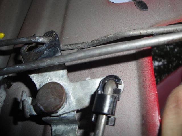

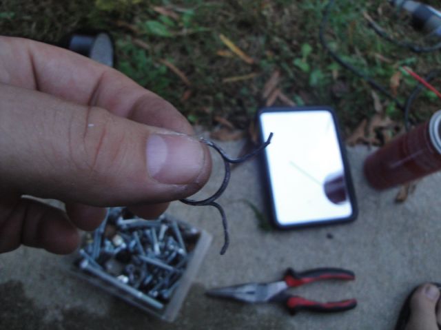

I just replaced the actuator, hit the lock parts with white lithium grease, removed the spring on the actuator bracket assembly, and also bent the actuator bracket tabs in ward tighter on the lock rod. It actually works now.
