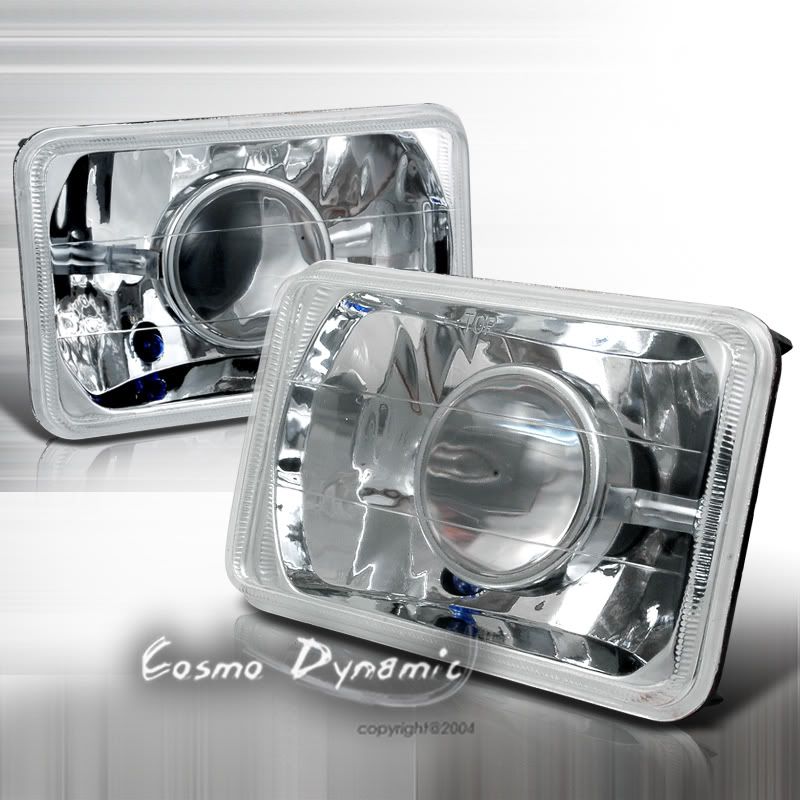

ok i found these headlights online and want to know if anybody has them or has seen them, iam gonna upgrade no matter what just wondered if i should go with the projectors, i have them in my BMW and in my truck and they are great

HEY JUST INSTALLED A SIMMILAR SET, HAVING PROBLEMS WITH THEM STAYING ON. DON'T KNOW WHATS GOING ON MINE EVEN CAME WITH A HARNESS I DIDN'T HAVE TO CUT ANY WIRES AND THEY ARE NOW GOING OFF AND ON. THEY WILL STAY ON FOR A LIL WHILE AND NEXT THING I KNOW I DON'T HAVE HEADLAMPS ANYMORE.????????
ANYONE HAD THIS ISSUE.

If you are using H4 bulbs in your car the problem has to do with your Headlight switch being overloaded. The stock headlights for the car are only meant to draw something like 55 watts of power and most H4 bulbs draw somewhere around 90 watts. You need to go onto summit and look up the harness that APC sells. What the harness does is it draws current off the battery directly instead of only through the headlight switch thus alleviating the overload on the headlight switch. There are other ways to make it work with relays and such but by far the easiest solution for this problem is the aforementioned harness.

I think there is a little bit of confusion here. HIDs are not always projectors and projectors are not always HIDs. FWIW, those projector housings up top are worthless. I had those on my bird when I first got it and they do nothing but look cool. They don't actually 'project' the light any different than a free form housing and will just mess with the beam pattern. If you want good projectors you'll have to retrofit them into a free form housing and for all the work you'll do with that, you'll still have standard plug in bulbs. I'd take a little more time and money and get some good (Read: not ebay specials) HIDs. That means, the capsules, ballasts, projectors, and wiring. They'll actually suck less power than those higher wattage h4 setups and put out tons more light.
