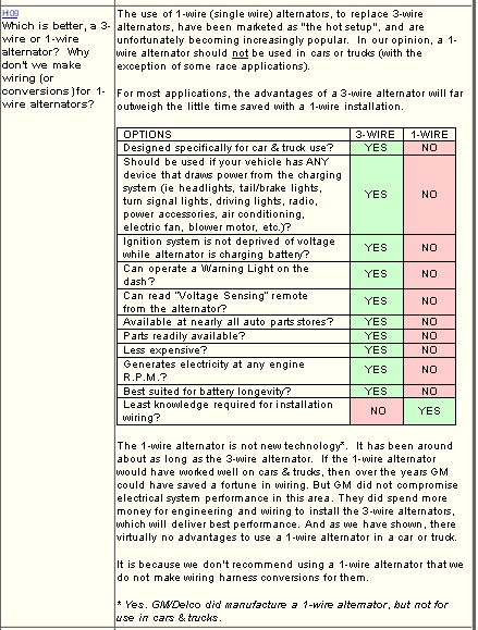

Are you aware of the disadvantages?

after i started asking around ive begun to see all the advantages and disadvantages. the point wasnt time savings, its was my friend gave me a brand new single wire and mine has been flakey. so i was going to convert, but after a few days of non-stop reading people saying it sucks so much its only for aesthetics (and i dont care a whole lot about form over function) i think ill stick with a 3 wire.
thank you.
