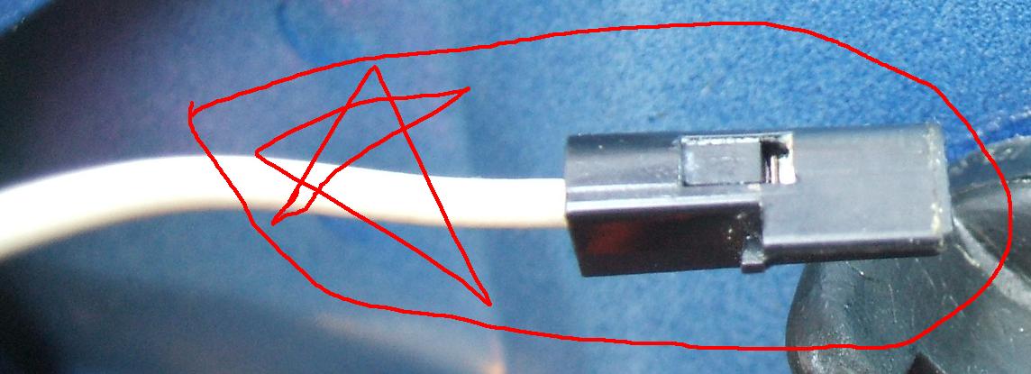

can someone plz tell me where the 2 wires in the attached pics plug in to?
Attached Thumbnails plz help 1986 hatch pull down wires-dscf3802.jpg   plz help 1986 hatch pull down wires-dscf3803.jpg

ok the one on the right is taken care of. any ideas on the left?

It is unused on your year of car. It was used on 1989-91 cars to turn on and off the rear hatch light. Your car has a manual switch. The later model years I already mentioned have that white wire plugged into a tan with white stripe wire. The wire switched off ground to the hatch light. If you want you can hook the ground of your hatch light to that white wire and the hatch light will be turned on and off automatically by the striker-sensing switch of the pull-down motor.

thanx man i got the whole hatch pull down assembly working like new now
