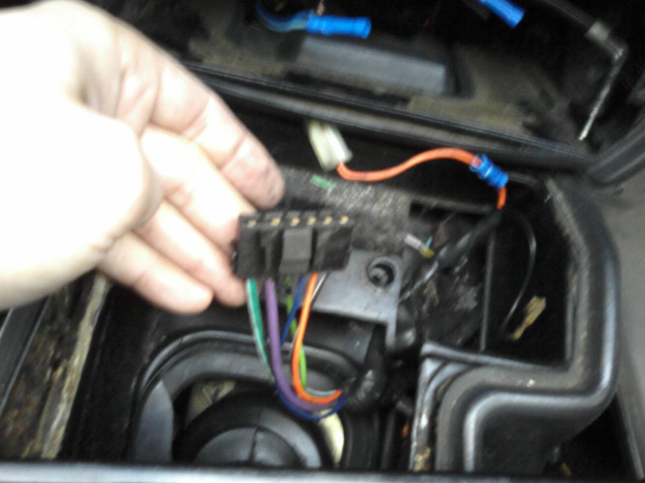

I found this plug while taking apart my console. It doesn't seem to belong here. any ideas as to where it goes. its not for the windows or electric mirrors.

that looks like the wiring to the neutral safety switch for a car with an auto trans. AFAIK that harness was installed in all cars regardless of man or auto trans

Yes, this is the connector for the automatic tranny shifter.
Left to right:
- dark green/white and purple - starter safety switch
- green and blue - reverse light switch
- orange and black/white - drive/reverse switch
Did your car come with the 350 or the T5? If it came with the T5, you should be ok.

It came with the 305 tpi and t5 but it now has a 4 bolt 350 carb. out of a 78 pickup. I kept the t5 in but I think I've got to much power for it. thanks so much for all your help.
