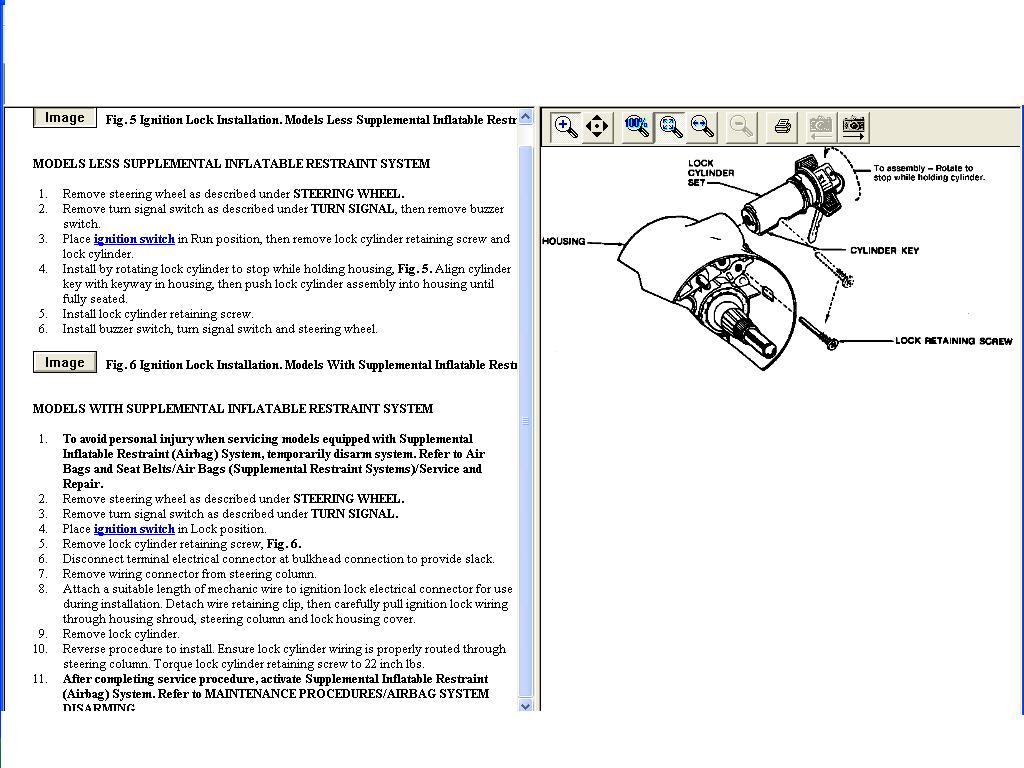

What all is involved with changing the ignition chamber that is in the steering column. I have an 89 Trans Am with the VATS system in it and I was going to change the chamber that the key goes into to start the car. Any information will be helpful. Thanks!

here ya go, if you need more info lemme know

Has anyone on here changed the ignition cylinder before? I am having trouble tracing the wire connection down the column. I don't know where it connects. Any more help on this topic will be GREATLY appreciated.
