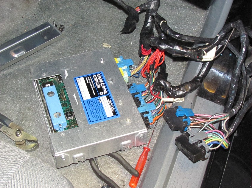

Code 42 - Its back, running just as before second cooling fan won’t turn on even with a/c on. The car can’t get out of its own way runs like crap!!! Stars right up runs for like 20 seconds and then the SES light comes on, if you put it in gear it doesn’t even want to more the car unless you really push it hard and then it will go done the road barely.
What are the other harness connections at the ecm for? Can’t find any were they would plug into?

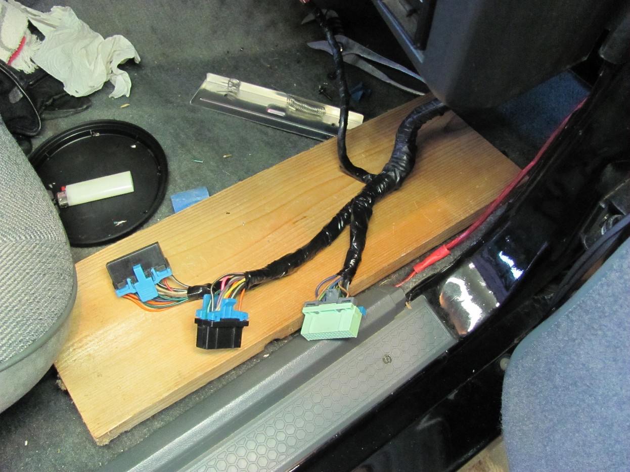

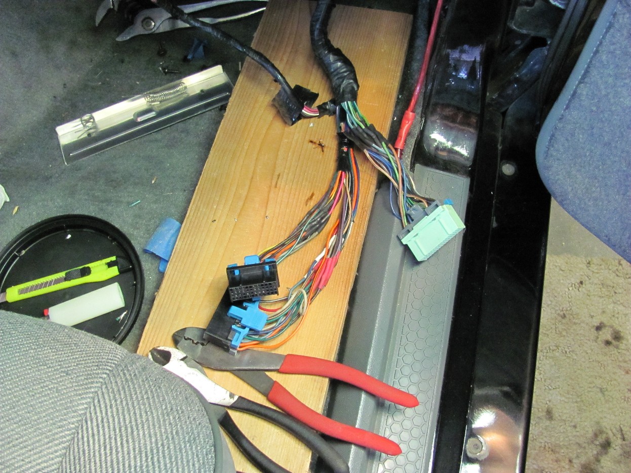

It turns out that the other connectors were from a performance programmer the previous owner installed, I removed them and repaired the wires and installed a new ecm, from OReilly’s, I have checked the continuity and ohm of the tan w black strip wire from the distributor to the ecm and it checked out ok. I sent the prom out and had it check and it was bad so they flashed it with the stock settings. When I installed everything it still ran bad but if I install the prom with performance piggy back it doesn’t give me the SES light, if I remove the piggy back and install the stock prom it runs the same and the SES light comes on (code 42). So I am thinking that the stock prom is the problem.
Also I have checked all the wires for the ecm and several of them show an ohm reading to ground not sure but that doesn’t seem right?
Any input is greatly appreciated.
