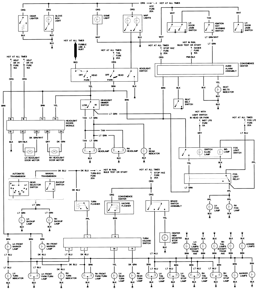

Anyway, electrically and logically (going by this diagram: http://www.austinthirdgen.org/mkport...dy_wiring.gif), it sounds like the headlight module might have an internal short.

thanks for the reply's. I should say when the buckets go up and down, there is a ' humming ' sound for several seconds afterwards. I have never had a problem with the lights/buckets before this. I was just trying to get an idea before tearing everything apart.
