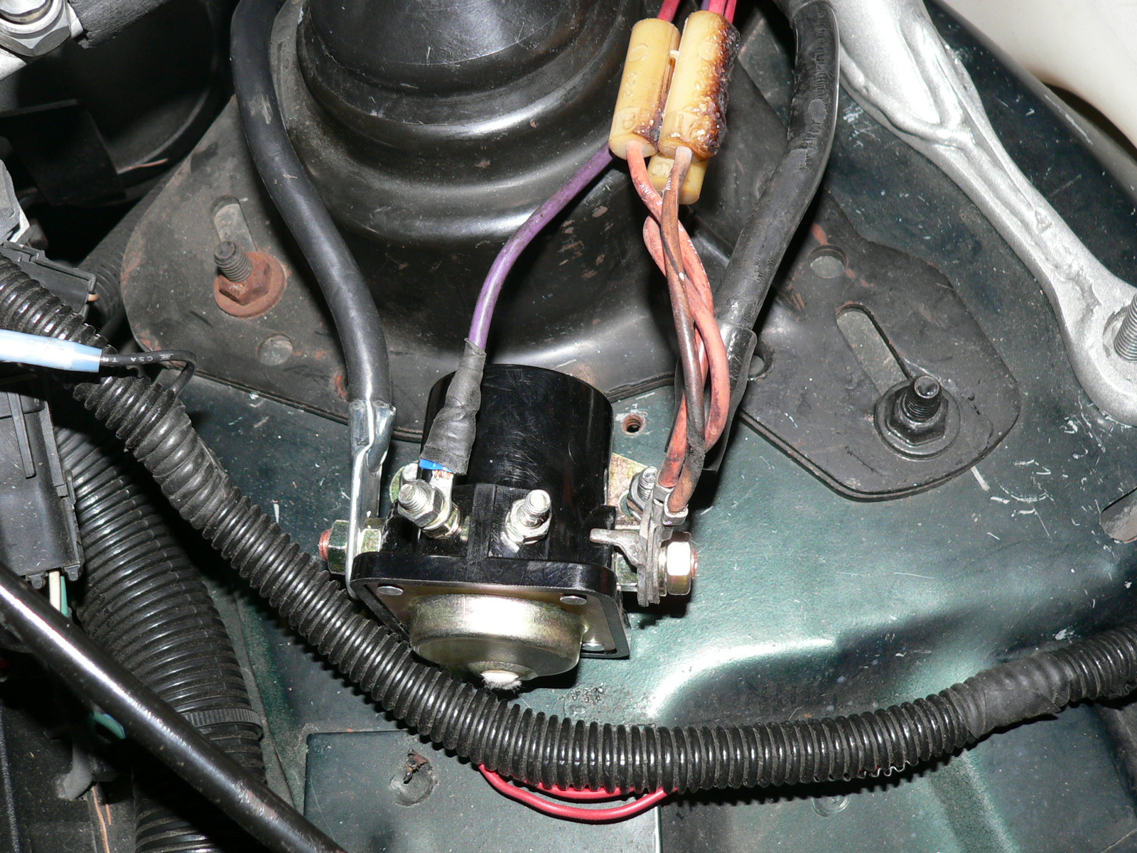

I got it wired up so now I get the ford solenoid to activate power to the starter side terminal.
I have the GM starter with power and have the short to the s terminal.
When I turn the key I hear the ford solenoid click, but nothing happens with the GM.
Any suggestions?
Any suggestions?

I got it all fixed now.
I am attaching a photo to show the Correct wiring for the solenoid.
Hopefully this will help others in the future.
Burned up a starter by puting the power to the wrong terminal side.
Instructions said just choose one.
So much for instructions!!!!
I would like to thank Mark at http://www.madelectrical.com/
for checking my final setup and teaching my the reasons behind the need for a remote solenoid.
Check out their web site and contact Mark for electrical help. He is very knowledgable.
