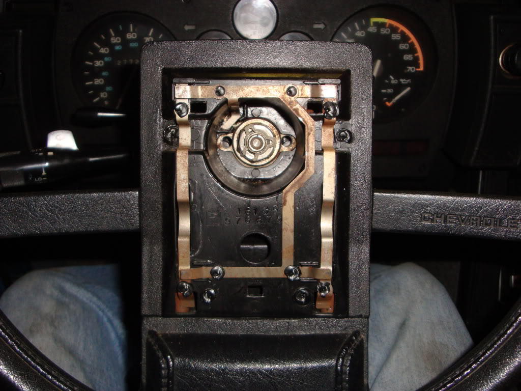

Just picked up my first 3rd gen today..well..technically yesterday. I'm trying to address the things I need to pass inspection. One thing is the horn. BTW, its an 89 RS 305 TBI.

With the cover off.

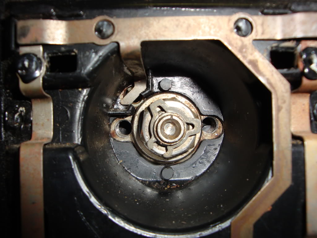

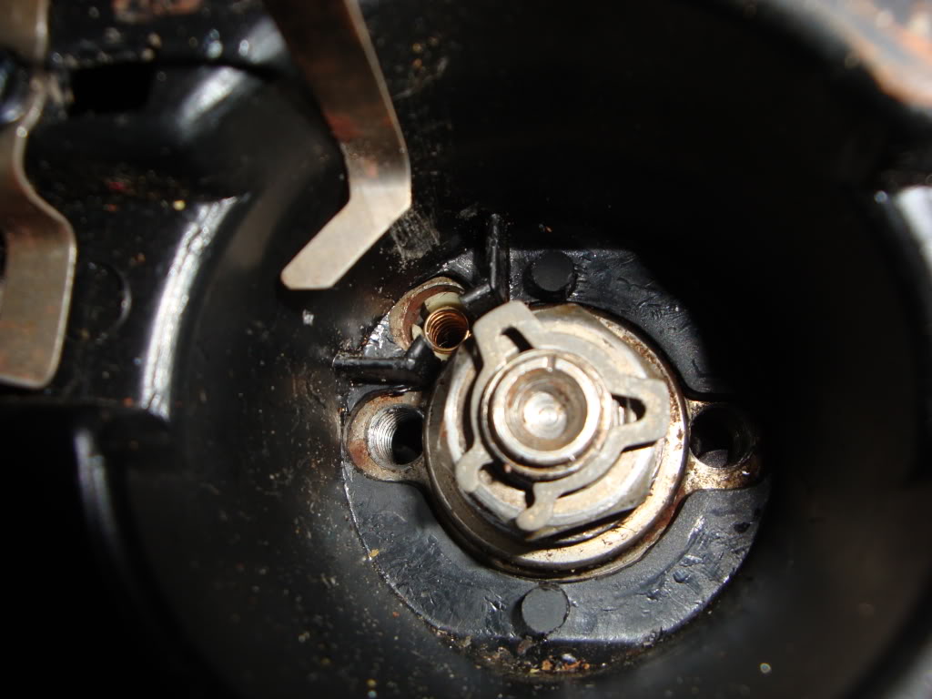

I'm guessing that any one of the 4 corners of the copper rectangle need to contact to complete the circuit but it seems like there should be something underneath that copper part that extends down into the steering wheel near the wheel nut, but there is only a threaded hole under it.

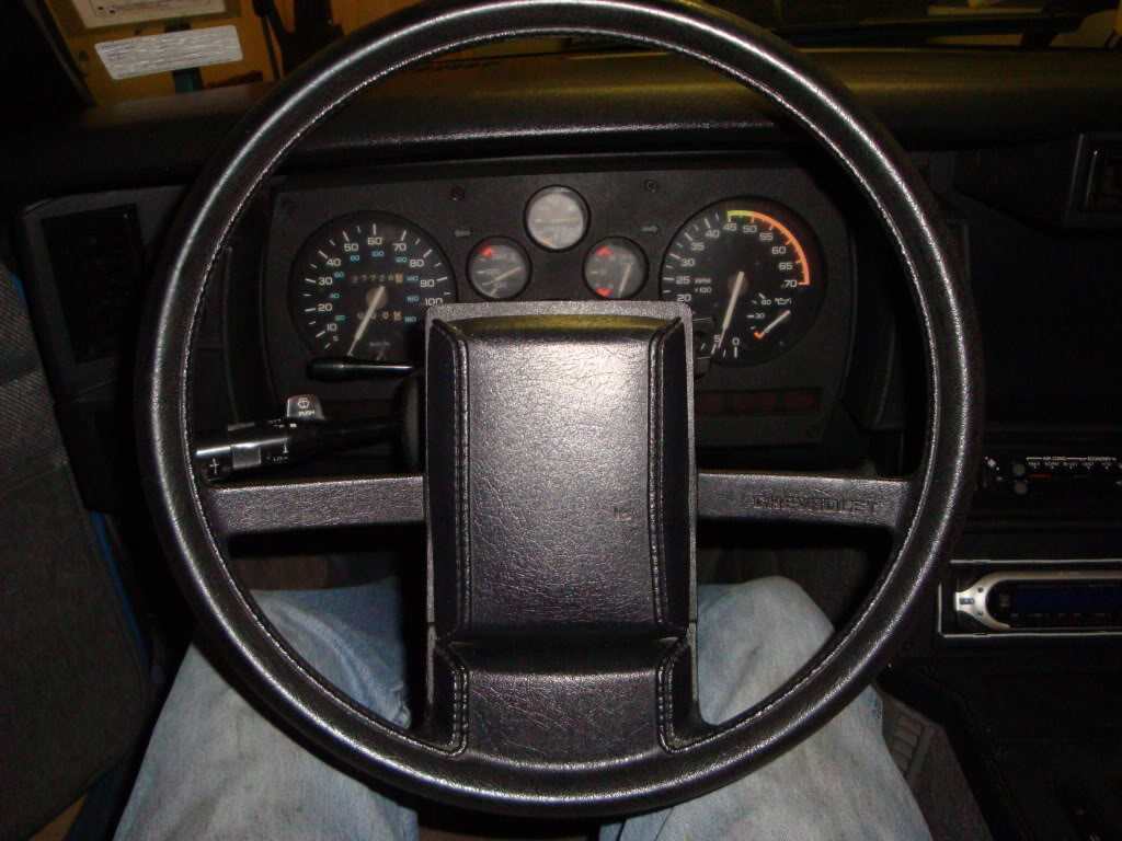

Here I have the copper part pulled up so you can see the hole underneath better.

Am I missing any parts to make the horn work or do I just need to start troubleshooting the rest of the wiring?

Yeah I'm missing the same thing, I think it's a pin that goes through the center of the spring... Anyone have a part number for us?

Don't know a part number but you are missing the contactor that clips in there. Maybe a JY could help. It's possible though that the tang on the piece you have remaining (with the spring inside) is broken and that's why you're missing the contact pin. It pushes in against the spring then twists a 1/4 turn to lock into place...or maybe I'm thinking about the pontiac horn?
Either way I'd go to a JY with a puller and bring back both pieces. The one mounted in the wheel and the contactor you're missing.
